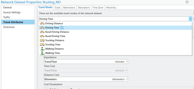

It is hard to say what may be going on. But let's start with looking at the properties of your network dataset in the Catalog pane. On the traffic attributes you should be able to see if you have travel modes like so:
If you do see your expected travel modes then I suggest starting a new project in Pro, adding your network dataset and then creating the OD Cost Matrix layer. Does the ribbon at this point show you your travel modes? If yes, then you can continue with loading your locations.
If not, then we have to diagnose it more on what could be going on.
