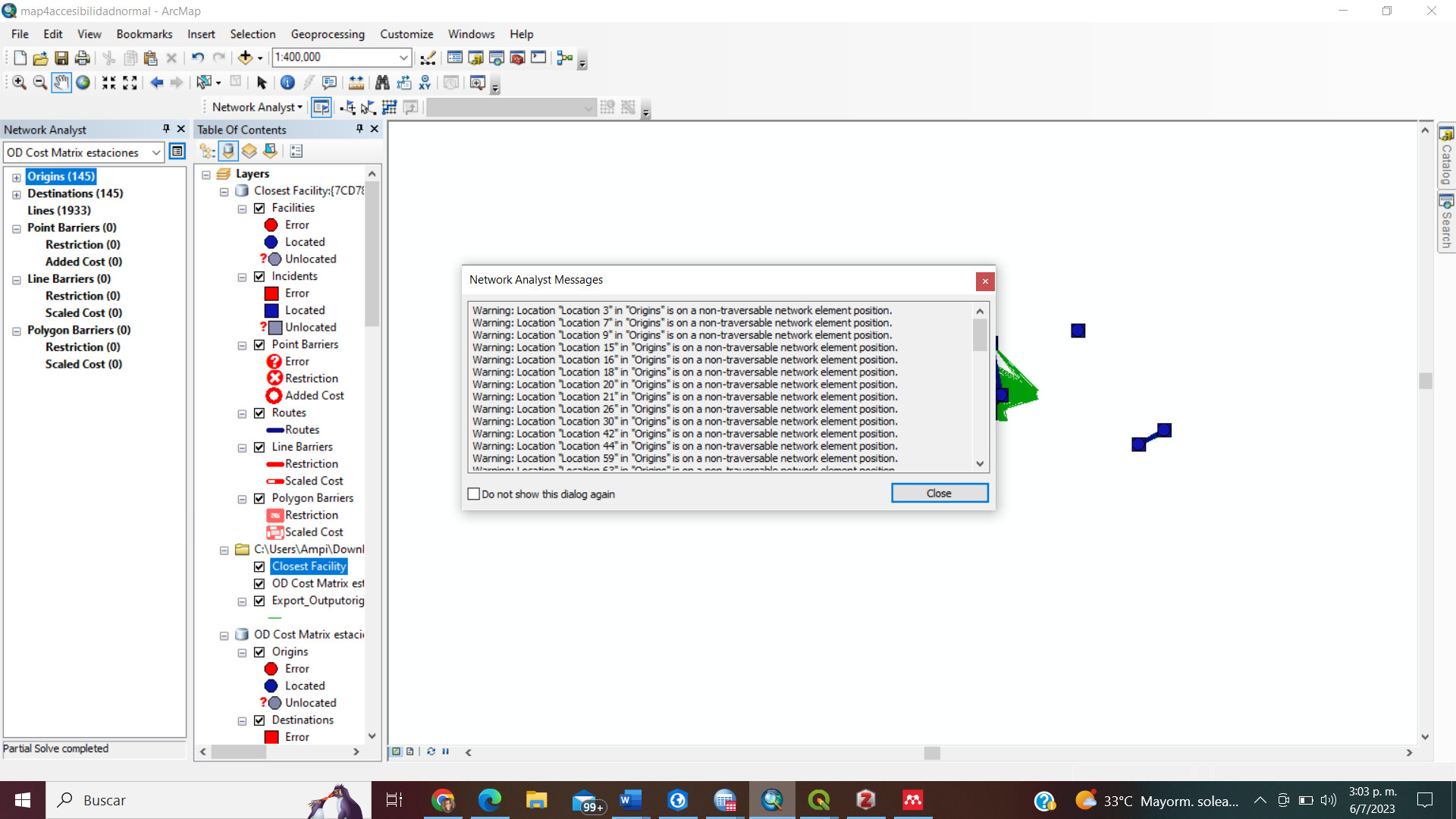

I have this problem (Non-traversable network element position )

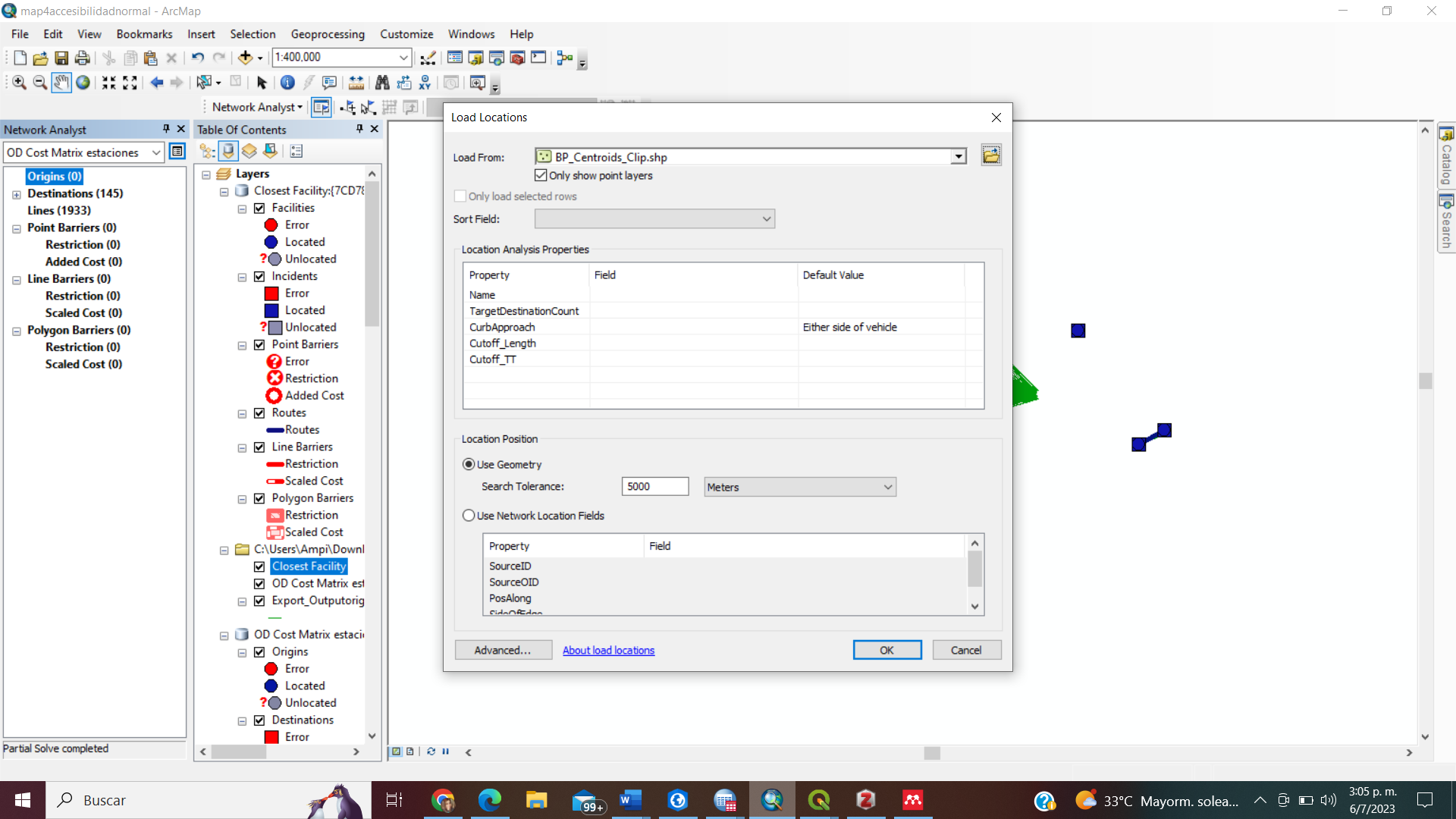

I don't know how to solve it. When I load the locations, I don't find the "Exclude restricted portions of the network" button to click.
Where does the "Exclude restricted portions of the network" button appear? Is there any other way to solve this problem without that button?
MelindaMorang
I think that option isn't available when you use the Load Locations dialog, but you can find it in the Add Locations tool.  That tool does the same thing, but it uses Geoprocessing.  https://desktop.arcgis.com/en/arcmap/latest/tools/network-analyst-toolbox/add-locations.htm

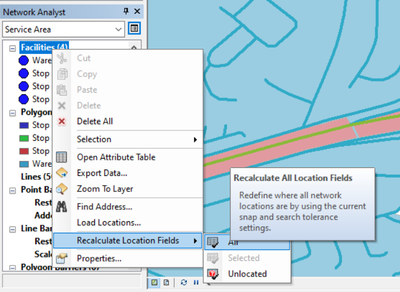

In the TOC, right-click on your Network Analysis layer (OD or CF) and bring up its properties. Click on the Network Locations tab and there is setting towards the bottom to Exclude restricted portions of the network. See screen shot below. You can turn on the setting and it will be honored next time you load locations. For existing locations, you can right-click on the Facilites or Origins/Destinations in the NA Window and choose to recalculate the existing locations (second screen shot below).
