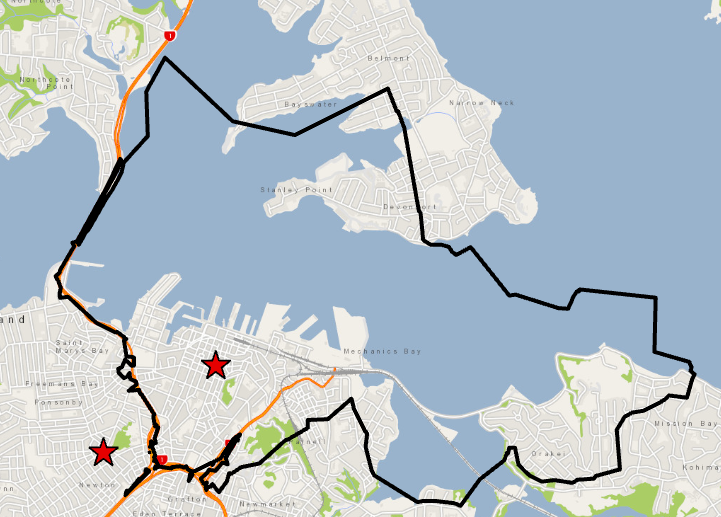

Here is a screenshot of an example (Auckland) where the service area includes the end of a peninsula, but should not.

Are you using ArcMap or ArcGIS Pro?  This is an important distinction because Pro uses a newer Service Area polygon generation algorithm.  Pro's service areas will generally be cleaner and neater, and polygon barriers should be neatly clipped out from the results.
You said: "I'm creating generalized precision service areas because the standard precision output excludes a lot of area that I would like to be included."
Can you elaborate?  It sounds like you have some area you want to be included and some area (like water bodies) that you want to be excluded.  Sounds like a hard balance to strike when the only thing the Service Area algorithm knows about is which roads were reached.

I started off using standard precision, however a lot of NZ roads are rural or considered driveways, and therefore weren't considered part of the network. The standard precision also creates uneven boundaries/unnatural shapes when service areas overlap, so I went ahead with generalized precision.
Does network analyst consider ferry routes to be part of the network? Could this be why it's including islands/ peninsulas? Can I add my own road network and use that instead?

What's considered "part of the network" entirely depends on which network you're using for your analysis? Are you using your own network dataset (something you created or your company/city created)?  Or are you using Streetmap Premium that you purchased from Esri?  Or are you using the ArcGIS Online services?
In general, if you're missing rural roads and driveways, there are two possibilities:
1) Those rural roads and driveways aren't in the network at all and need to be added.
2) They are included in the network, but your travel mode settings prevent travel on them. If you don't want them to be restricted to travel, you just need to update your travel mode settings.
Regarding ferries: If your network dataset includes ferry routes and the travel mode you're using for your analysis allows ferry travel, then yes, ferries will be used.

I'm just using the ArcGIS Online services, however I will look to use our own network and exclude the ferry routes, and also update the travel modes. I'll come back here if I run into more questions.
MelindaMorang
You can modify your Service Area layer's travel mode even if you're using the ArcGIS Online services.  On the Service Area ribbon, there's a little launcher button in the travel mode section. You can click that to open the layer's Travel Mode properties and configure which restrictions are being used.
