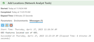

Recalculating the index does not improve the speed. It took 6 minutes and 25 seconds to load 603 locations. See below for the results.
The data is being located from a location on a network, there is no local drive to access the data from as Pro is on a Virtual Desktop (VMware).
