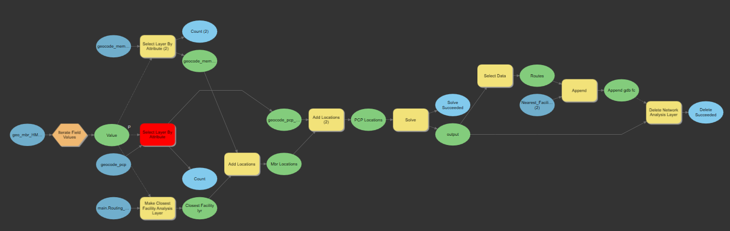

I'm iterating through 1.4 million members and 10k providers to calculate the route from member to provider. Find routes tool worked but dissolved member routes, thus why I ran nearest facility. The model has been running for 7 days.  It's working it's just lagging.  Any tips on how to increase performance?  I am running locally on laptop and don't have GeoAnalytics Server.

Thanks for your reply.  To give you more context, I have members that are linked with a specific provider.  Thus, I ran the Find Routes tool and linked the member and providers, but the routes were dissolved, and I needed individual routes represented in the attribute data.  So, I tried to iterate through the data and select members and the provider to calculate the routes.  If I didn't need to link the members with the provider they saw, it would be an easier task.  I'll look at the links you provided. Thanks.

Wanted to thank Melinda and Jhonatan for their guidance.  The Solve Large Analysis With Known OD Pairs Python Script tool is a game changer. I will never touch ModelBuilder again.  🙂
