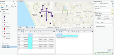

Yes. It is possible. Here is one way: Use the Summary Statistics GP tool. The input should be the routes feature class from your Closest Facility layer. Open the route table, and sort ascending on the Facility Rank Column. Then right-click the Facility ID column and bring up the Summary Statistics. Choose the FacilityID as the statistics field and pick Concatenate from the list of statistics type drop down. Then type in a comma in the concatenate separator and run the tool. It will output a new table with a field that has all the FacilityID's separated by comma. See screen shot below.

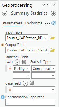

claykitchens_fd
Thank you, Jay!
One item I failed to include is that I'm trying to perform this action for 15 locations and 397 incidents. I followed the workflow you provided and received the following results.
How should the workflow be adjusted to accommodate 397 incidents?

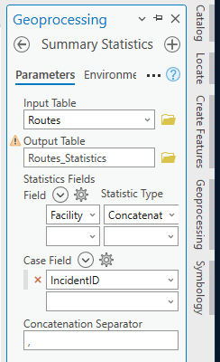

claykitchens_fd
Hi, Jay-
I made a change to the Summary Statistics parameters and I received the desired results.
I added IncidentID to the Case Field section and it produced the desired results.
Thank you again for taking the time to help!

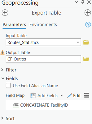

JaySandhu
The display only shows a limited amount. You can increase the width of the field display in the UI. But how do you plan to use this information? For example, you can use the GP tool Export table and output to a text file. You can also choose to only export that one field you want like so:

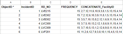

claykitchens_fd
I attempted this workflow again, but I still received the same output.
What I hoped I would see is the Incident ID field and the concatenated Facility ID values in another field (ConcatenatedIDs).
Incident ID  |  Concatenated IDs
1  |  2,1,3,5,4,6,10,9,8,11,7,15,13,14,12
2  |  1,3,7,4,10,13,14,2,6,5,9,8,12,11,15
... and this could continue to Incident ID 397.
Thank you so much for your help with this! I hope you will be able to provide a solution with this additional information.
