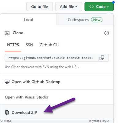

I have created a version of the tools where I have attempted to fix the problem, although since I can't reproduce it, I don't actually know if this will work.  If you have the time, would you be willing to try it?  Please use the same set-up you currently have that cause the tool to fail, but use the updated version of the tool.  You can download it from this GitHub branch: https://github.com/Esri/public-transit-tools/tree/fix-encoding.  (If you're not familiar with GitHub, you can download the files as a zip file:
Be sure to close and reopen ArcGIS Pro before trying the new tool version.  Otherwise, the code will be cached, and Pro won't use the new version.
