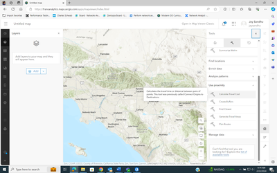

JaySandhu
You have to create or have an account for arcgis.com and sign in and click on the map viewer. Then on the right bottom you can click the star icon to access the tools. See screen shot:
