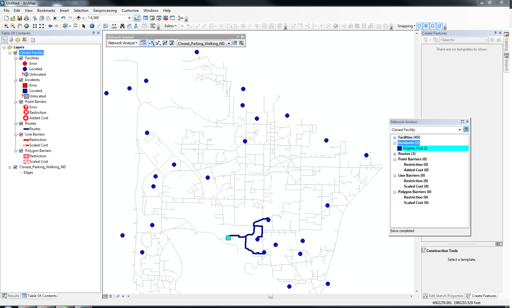

This is an ideal scenario:
The three closest facilities are returned, with correctly-drawn routes.

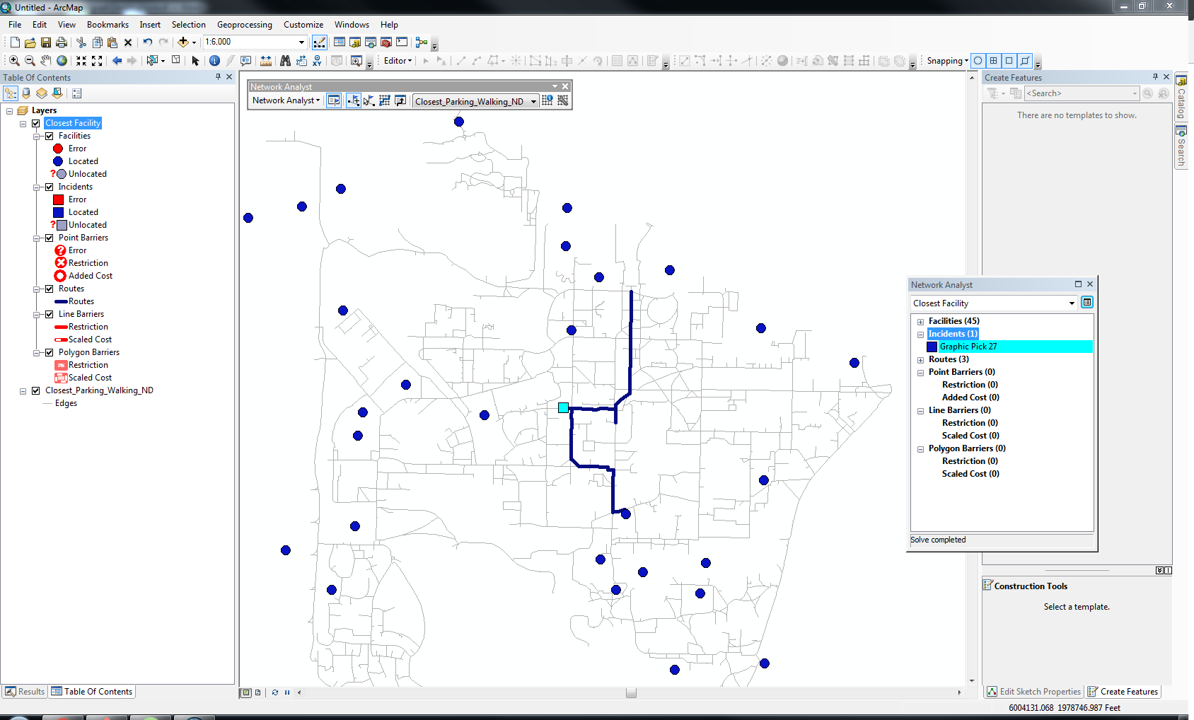

This is a slightly less ideal scenario:
The routes are correctly-drawn, but you can tell that it did not select the three closest facilities.

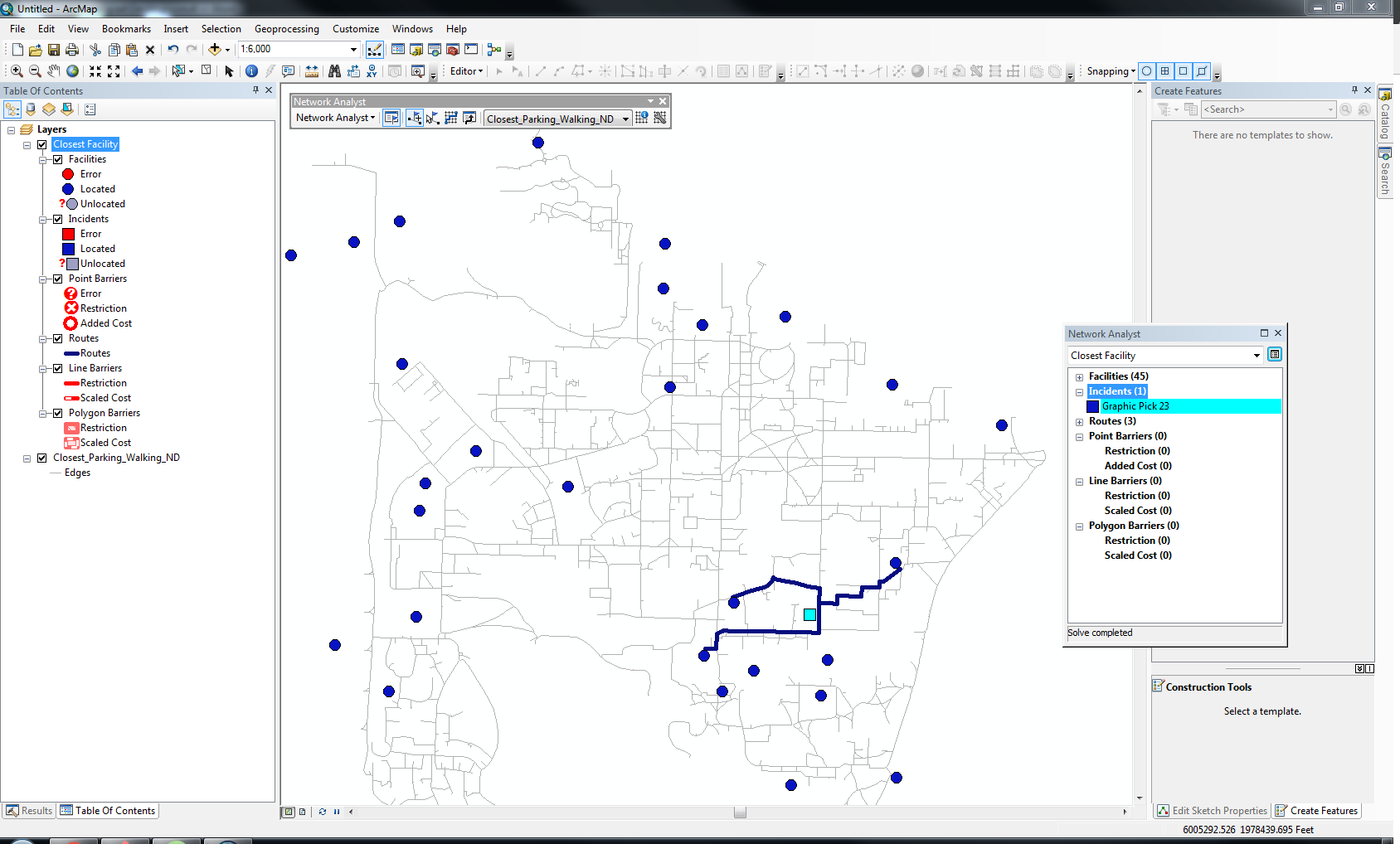

This is the worst case scenario (most common):
The facilities selected are not the closest, and the routes are cut off early (usually once it hits the facility's y-axis).

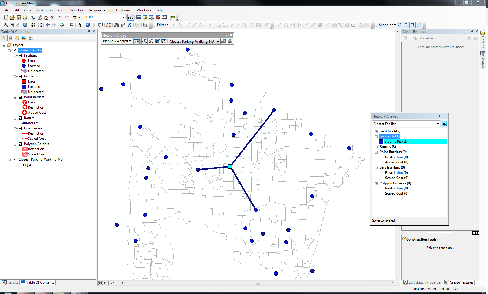

This is the same worst case scenario, with drawn with straight lines:
This is to show which facilities it was attempting to route to.
