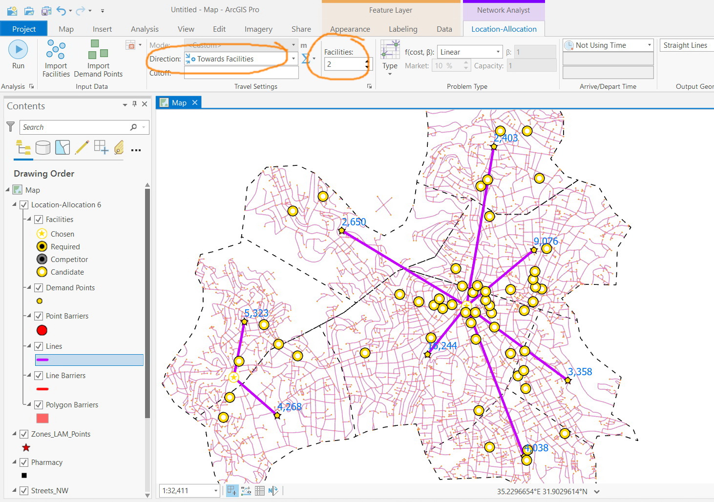

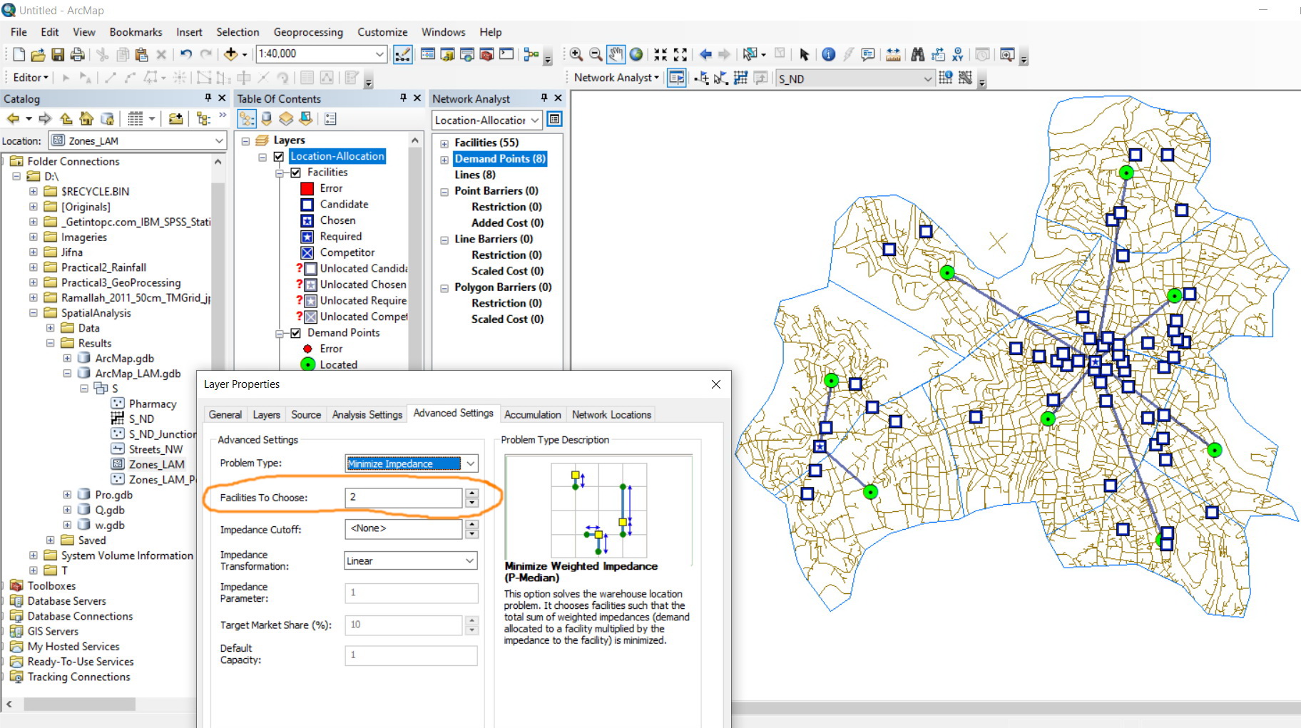

Despite the fact that running “Location-Allocation” model in ArcMap manages to allocate potential destination for each demand point, Pro leaves two of these demands with no such potential destination knowing that all the assumptions are identical in both ArcMap and Pro
What could be the issue here?

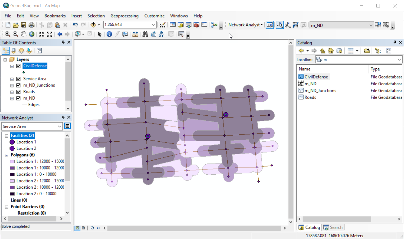

JaySandhu
And here is the output from ArcMap with the Service Area Index and same trim settings. It matches Pro.

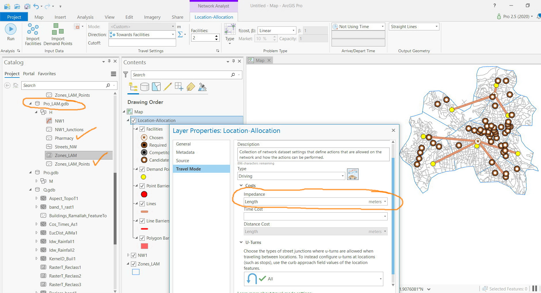

I’m still getting the same issue for the location-allocation. Same settings in Pro and ArcMap lead to different results. The data is attached (Facilities: Pharmacies, Demand: Zones)
