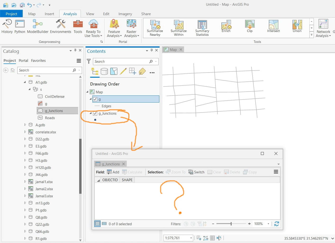

I couldn’t figure out why the “create network dataset” tool ends up with an empty “junction” layer.

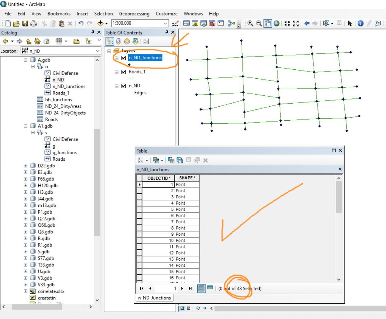

In ArcMap, the created “junction” to used to have point at each intersection

Thanks Dan.
In ArcMap, as the network dataset is created, the junction layer is created by default and filled with all values without the need to build the network. In Pro, the junction layer is created but empty. The "build network" tool resolves the issue
