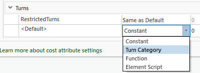

To set up a Turn category evaluator in your network,
  1. Open the network dataset properties
  2. Go to the Travel Attributes page, Costs tab
  3. Select the cost attribute you want to use in your analysis in the upper half of the page
  4. In the bottom half of the page, scroll down to the Evaluators section
  5. Find the Turns heading and the row labeled <Default>
  6. Use the drop-down to select Turn Category for the evaluator type.
  7. In the Value column on the right, double-click the cell to activate the configuration button.
  8. Click the button to launch the Turn category evaluator dialog and configure the settings the way you want them.
