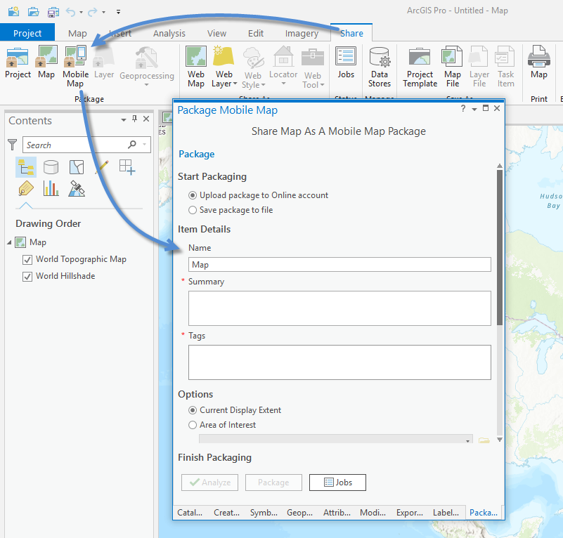

In addition to what Joel said... you may also want to use the New (for Pro 2.2) Share -> Mobile Map  user experience.  The Name and Title are the same in this UI.
