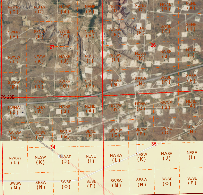

any updated timeline on this capability?  If implemented, would I be able to use the network from StreetMapPremium Custom over the imagery (ie, instead of the cartoon map currently included?)  We're navigating two-track farm roads, forest roads and/or oil field service roads that may or may not be included in StreetMap, and until we are able to add these to the road network ourselves, we'd like to have the imagery for heads-up navigation where StreetMap doesn't exist.swipe view of imagery and Streetmap: 10 sq km area in SE NM, USA where StreetMap has only 6 roads, while we travel on the more than 60 roads actually present
