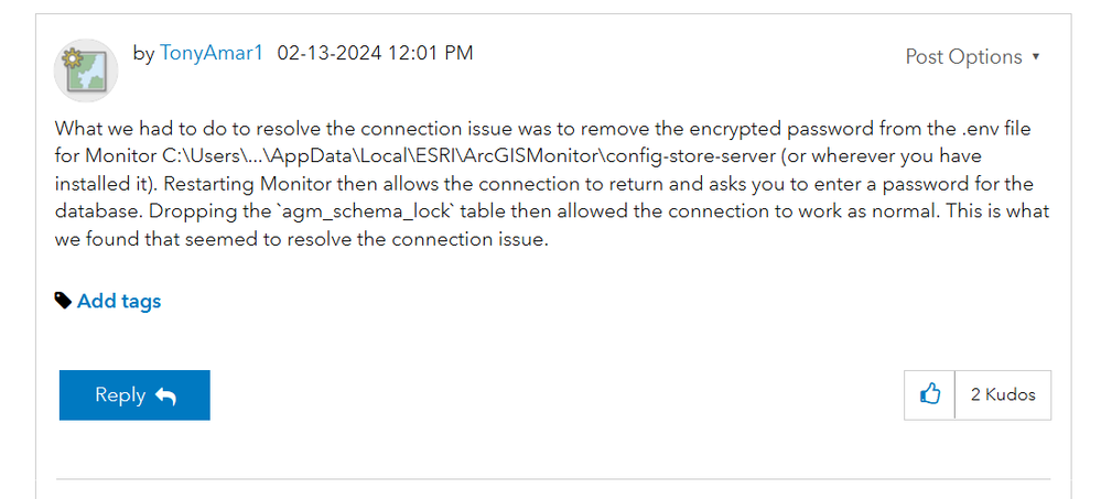

I had a similar issue when upgrading to 2025 today.
I followed the steps here and was able to connect my agm database back to monitor after deleting the encrypted password in the env file and performing restarts on Monitor Server and the postgres database service.
I tried to remove the lock file mentioned in this user's post but I didn't have one in postgres. I did get an initial error stating there was a lock but eventually it went away and I was able to connect again.
