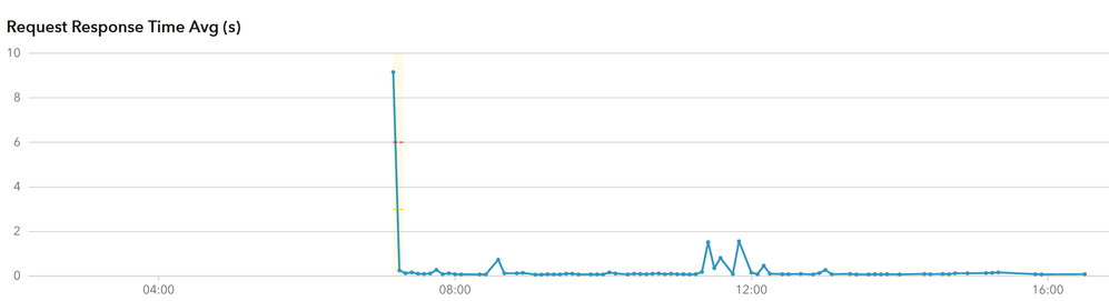

For example I have a service that will have a max response time of 11 seconds at what appears to be the first "hit" of the day, then all the subsequent max responses are below a second.
I'm just curious how others handle this, or what best practice is? I deployed the new Monitor shortly after it was released. We have 220 services deployed and since I turned on Monitor it's generated 12,721 warnings and 10,804 criticals...98% of these are from the max response time when a pooled service is just waking up.
Here's a graph:
Spikes first thing in the morning, triggering the warning, then it's fine throughout the day.
AndrewSakowicz
Thank you for the info.  Very helpful.  It appears, this condition impacts min 3 requests and lasts approximately 15 min, (3 points above, with 5 min interval).  If you change the alert sample from 3 to 5 (and potentially change aggregation to p95) the alerts will not fire for the above.
