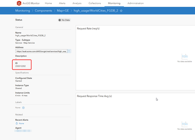

Hi @Tobias_Gerber, sorry to hear you're experiencing this behavior. I think this is a known defect, which is addressed in the next release of Monitor: BUG-000165954 - The ArcGIS Monitor Services component IDs are recreated intermittently.
To verify that this is the defect responsible for behavior:
1. Take note of the component ID of one of the service components that you have noticed missing data for.
2. After the issue occurs again, check this ID to see if it has a different value.
Josh

Thanks @GeoJosh for the quick answer. I've noted the IDs of those services and will check the next days for any changes.

Hello @GeoJosh
Just 1 day later, the IDs for the services on one of our stage have already changed. Accordingly, I now only have the metrics for 1 day back for them.
I am glad to hear that there is already a known bug for this problem and that it should be fixed in the next release.
Is there any workaround in the meantime? Having only a 1 day history for the service metrics is quite a heavy functional limitation...
