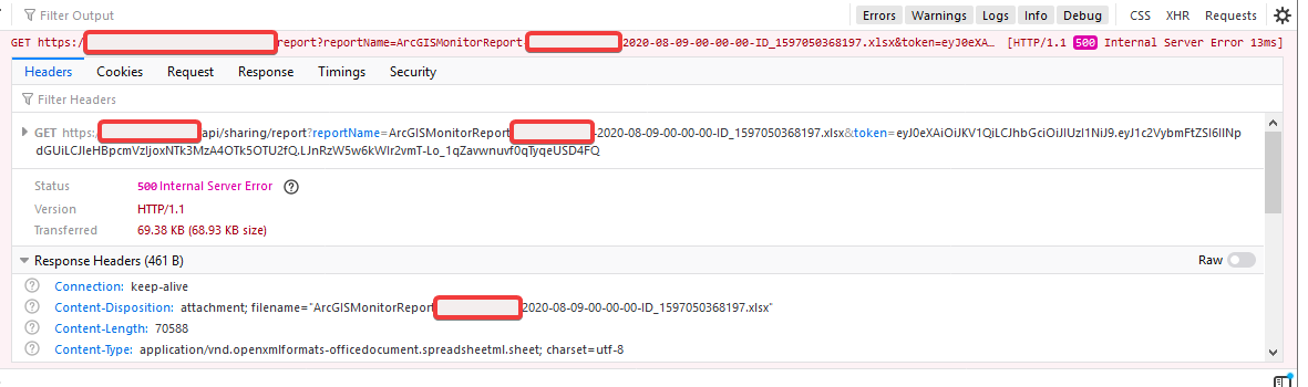

Hi there,
When trying to execute an excel report from the ArcGIS Monitor site I'm seeing an internal server error
I can see the reports being generated in ArcGIS Monitor\Server\maintenanceServer\reports
This is a fresh install. Anyone seen this before?
Thanks
EDIT: Worked it out. My collection name had a special character which I believe wasn't being encoded correctly when requesting the xlsx url. I renamed the collection and all is golden. Posting this so I remember for next time.
