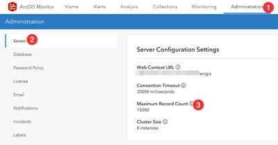

This is governed in ArcGIS Monitor Server by the Maximum Record Count setting (Administration > Server > Maximum Record Count).
However, this is set to 10,000 by default. If you haven't changed this setting, then I suspect the limitation is being imposed on the Dashboard side.
