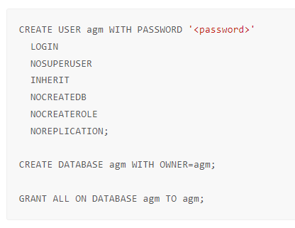

To create the ArcGIS Monitor database in PostgreSQL, did you run the script that is provided in the help topic you referenced? The script creates a new database called "agm" and a user called "agm" with the appropriate permissions.

Yes I got that:

If this is a new Monitor install, then can you please delete your current agm database and re-create it using the script provided in the help topic?
