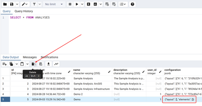

  4. Issue this query: SELECT * FROM ANALYSES
  5. Take a CSV backup of the results.
6. Delete any row where the expressions array under the configuration column is empty or is missing entirely. For example, a row with the configuration object below would be deleted, because the expressions array is [] (empty):
7. Start the ArcGIS Monitor Server service and try accessing the application again. If the problem persists, please reach out to Esri Support for further troubleshooting.
