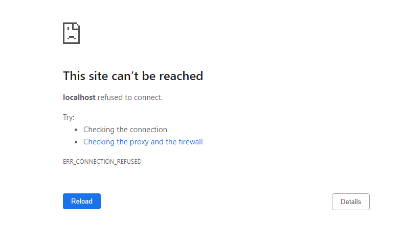

*Edit*: There are 3 instances of ArcGIS Monitor Running in task manager.
Hello All,
I have ArcGIS Monitor installed and authorized.  However, when I try to access the setup site "https://monitorserver.domain.com:30443/arcgis/monitor/setup" or click on the shortcut I keep getting the following error:
I have done all of the standard things like reboot the server, clear browser cache, uninstall/reinstall (as an administrator), tried a different browser and ran a modified installation.  All of that and I still can't reach the site.
I then called in a coworker for some assistance and they suggested trying through http but the same result.  we then got looking to see if those ports were open.  I ran a netstat -ab command, copied the results into Word and tried searching for port 443 or 30443.  Neither one was listed.  I then googled how to open ports in windows server.  Went to administrative tools<windows defender firewall with advanced security<inbound rules and proceeded to add a rule for ports 443 and 30443.  Once again tried to access the site but still no luck.  I then got into the properties of those rules and noticed a "programs and services" tab.  Clicked on that and set the service to the ArcGIS Monitor service but still no luck.
One last thing I tried was to stop IIS from running but that also had no effect. I am pretty sure it must be a setting on my server but I have run out of ideas as to what or where to look.  Thank you in advance for any ideas we haven't thought of.

GeoJosh
Chris,
If you stop the ArcGIS Monitor service, can you confirm that all 3 processes in Task Manager are also terminated? If any of them stick around after stopping the service, manually stop them and then restart ArcGIS Monitor service.
Josh
ChrisRobinsonCOF
Josh,
Stopping the ArcGIS Monitor service closes all three instances of ArcGIS Monitor.exe in task manager.
Thank you,
Chris
ChrisRobinsonCOF
If I restart the service, those 3 instances fire back up.
GeoJosh
Chris,
I think this will require a deeper look. Can you submit a case for this issue with Esri Support?
Josh
ChrisRobinsonCOF
Josh,
Ok, will do.  Thank you for the assistance.
Chris
