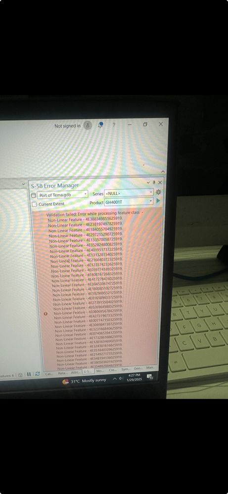

S-58 Error Manager fails when trying to check for errors. Indicates that there is an error while processingIMG_1592D8B01B49-1.jpeg

Hello @GabrielAweya , seems like you have some non-linear geometries in your data. Non-linear geometries could be introduced by creating circles that use Bezier curves. Bezier curves are nonlinear segments defined by four control points. Non-linear segments are not supported in S-57.
Please see this thread, where I elaborate on how you can convert Bezier curves to linear features: https://community.esri.com/t5/arcgis-maritime-questions/error-when-exporting-to-s-57/m-p/1351363/hig...
Let me know if it helps.
