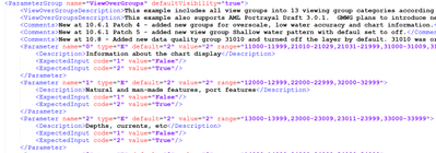

If you are adding new S-57 Objects, those objects when entered into the S-52 lookup tables will need to be assigned a view group.  If you create new view groups, then you will need to make sure those values are also added to the S52DisplayProperties.xml file at the bottom in the ViewingGroups sections.   Then verify they are in an existing range under the ParameterGroup name = ViewOverGroups.  This defines the layers that are created when you start the Maritime Chart Service's map service.  If they are not part of one of the layers, then those features cannot be turned off in the display.  This is all part of S-52 and defined in the documents I mentioned.
