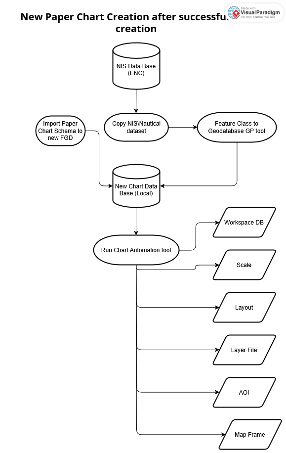

I have a question regarding Paper Chart Creation using Chart Automation tool. Please see below workflow I did to understand main steps I should follow to create Paper Chart.
My Questions:
Q1. Do I need to create fresh FGD for local Paper Chart and import to it Paper Chart Schema?
Q2. After creating FGD for Chart can I import all Nautical datasets from NIS database for ENC using Feature Class to Geodatabase tool? Or c=should I use other tool for copying?
Q3. Do I need to copy Product Coverages polygon and Product Definitions relations together from NIS (ENC)?
I tried to follow these steps shown in Workflow Diagram but I got an error when I tried to run Chart Automation tool it said something like this features already exists.
If required I can create short video demonstration of error with all steps I took to replicate the error I am getting.
Thank you in advance for your assistance with troubleshooting my problem!
With respect,
Naur

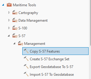

Do I need to use "Copy S-57 Features" tool to copy Nautical datasets to new Paper Chart Database?
PaulinaKarkauskaite
Hello @NauryzbekAbylkair ,
If you are expecting to maintain your paper chart products after the initial creation, I recommend establishing a one-way replica from your NIS. This workflow applies if your NIS is in an enterprise geodatabase.
  1. Create a paper chart schema in an empty file geodatabase. See: Create an S-57 or Paper Chart database)
  2. Establish a one-way replica from the NIS to your paper chart file geodatabase - this includes copying the data. Make sure to include the PLTS_FREL and PLTS_COLLECTIONS tables in the replica definition. See: Create a one-way replica
  3. Run CAT on your paper chart product geodatabase. See: Automate chart finishing.
  4. Next time you make data updates in your NIS, synchronize your paper chart product database using the Synchronize Changes tool.
If your NIS is in a file geodatabase, you can use the Copy S-57 Features tool to copy data to your paper chart product database. The tool respects selection, so you can select the features that intersect the paper chart product AOI before running the tool.
