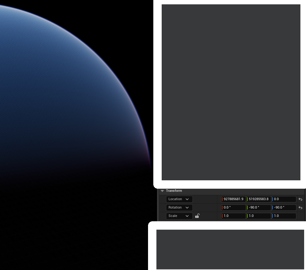

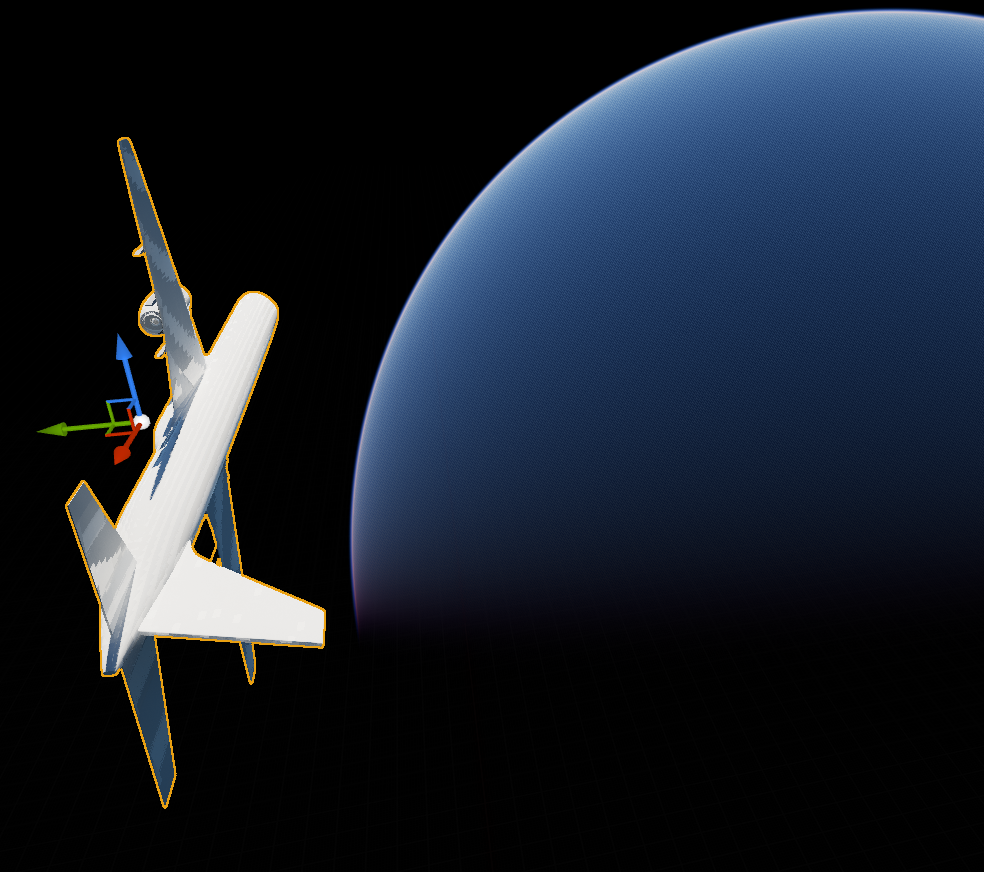

In the editor, UE5.1  I've attached the ArcGIS Location Component to an actor, and placed it in the world where I want it (sitting on the ground).  I save all, and exit.  When I reopen the project and the editor loads, that actor blinks out of view.  I double click select my actor in the outliner, to find my actor in orbit around the earth.  I've added the same component to other actors and it doesn't do this behavior.  Any thoughts?The UE5 world coordinatesThe UE5 world coordinatesfly me to the moon!fly me to the moon!
