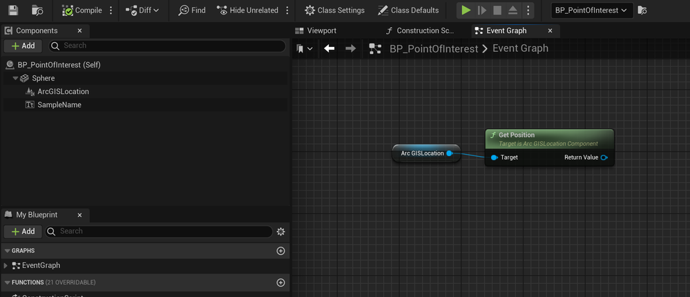

Here's a tangible step that I can't solve: I can't figure out how to even print the L-L-A Position geocoordinates of any actor, including the ArcGIS default pawn, or any normal unreal actor with an ArcGIS Location Component. The Get Position node (within ArcGIS SDK) outputs a name, for example, instead of a Vector or string with L-L-A.

actor->ArcGISLocation->Position should give you the position.

I'm in an Actor BP that has an ArcGIS Location Component. From the 'Get Position' node below, the Return Value wants to give an Arc GIS Point Object Reference. Is there documentation for how to setup Point Object References?
Is it only through ArcGIS Point Object References that I'm able to Get and Set ArcGIS Location Components that are attached to Actors?

Is this the pathway you're referring to when you say: actor->ArcGISLocation->Position ?
piercze
This is a bit clunky, but it does return the Long-Lat-Alt! The Vector variable on the right side serves my purpose.
There doesn't seem to be a node called 'Get Location' with 'Target is ArcGIS Point', but there are independent Get X, Get Y, Get Z nodes.
