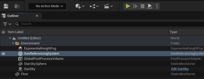

There appears to be a conflict with the GeoreferencingSystem actor in this Simulation template. After removing that, a Map can be created successfully.
We had a fix for this and it will go in for version 2.4. For now, we would recommend you either remove the GeoreferencingSystem actor before creating a map or just use the Blank template instead. Thanks!
