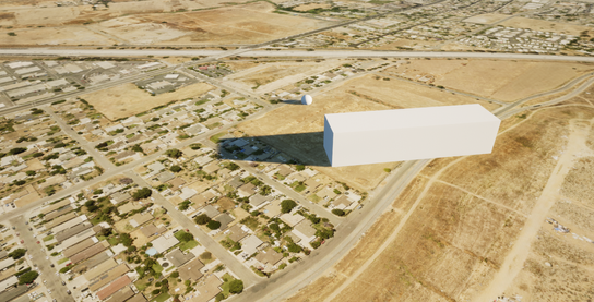

We succesfully implemented a drone, first person and a VR camera inside Unreal 5.02 together with ArcGIS SDK for Unreal (didn't update to the release version yet). When you setup a project on one side of the globe (in this case the Netherlands) everything works great and can switch between all the different cameras (see screenshots globe 1 and globe 2).
Then when we setup a project in the US (California) then hit play you fall down and see slide around the globe down:). See the images.

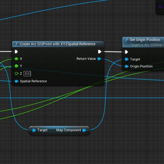

When you update the camera position could you also try updating the map's origin position to be in the same part of the world? This should update it so that the normalized vector to the earth is pointing up

Yes that is enabled and upgraded to 1.0.0 finally. Testing the sliding issue and will post our results.
AydinUluc
As always, thank you for your help.
