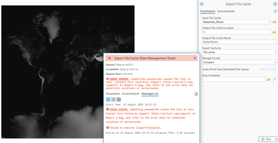

I then tried rasterizing some heightmap information and exporting that as a Tile Layer, which I could then edit the shaders in Unreal to use as elevation data. I was trying to export this rasterized layer using the Export Tile Cache function, but then I ran into an ERROR 999999 error code. I've been told that this could be a formatting issue with my input names or filepaths, so I've tried many different options, including just exporting directly into the C: drive and they all ended with the same error.
