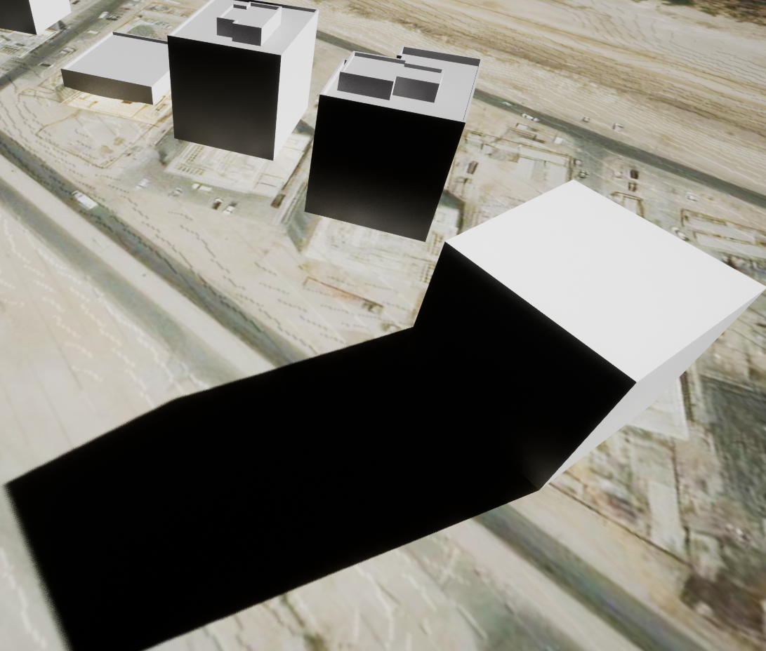

I'm loading buildings from an Arc GIS 3D Object Scene Layer, they work great but they don't cast shadows. Here is a screen comparing a standard UE cube (casting shadows correctly) besides the buildings layer which doesn't cast shadows:

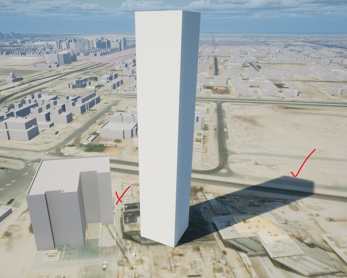

I also tested with just a Directional Light and again no shadow casting from the Scene Layer, but it works for the UE Cube:

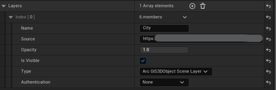

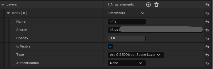

Here are the layer properties:
