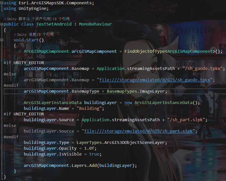

code:

void Start()
ArcGISMapComponent arcGISMapComponent = FindObjectOfType<ArcGISMapComponent>();
//arcGISMapComponent.Basemap = "file:///storage/emulated/0/GIS/sh_gaode.tpkx";
//arcGISMapComponent.Basemap = "file:///storage/emulated/1/GIS/sh_gaode.tpkx";
arcGISMapComponent.Basemap = "jar:file://" + Application.dataPath + "!/assets/sh_gaode.tpkx";
arcGISMapComponent.BasemapType = BasemapTypes.ImageLayer;
ArcGISLayerInstanceData buildingLayer = new ArcGISLayerInstanceData();
buildingLayer.Name = "Building";
//buildingLayer.Source = "file:///storage/emulated/0/GIS/sh_part.slpk";
//buildingLayer.Source = "file:///storage/emulated/1/GIS/sh_part.slpk";
buildingLayer.Source = "jar:file://" + Application.dataPath + "!/assets/sh_part.slpk";
buildingLayer.Type = LayerTypes.ArcGIS3DObjectSceneLayer;
buildingLayer.Opacity = 1.0f;
buildingLayer.IsVisible = true;
arcGISMapComponent.Layers.Add(buildingLayer);
