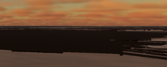

And if i get it to load, my integrated mesh data can look like this and I need to move the camera around to get it to load:
