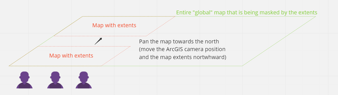

I've set up a "local map" and tried moving the ArcGIS camera and the extents together (so they remain in sync) and whilst this allows me to pan the map and always see a cutout version (i.e. a rectangular table-sized map) essentially what is happening is the map is showing a rectangular masked version of the map at different points in world space.
In the case of moving the ArcGIS camera and map extents at the same time, as previously mentioned for users standing around the map (each with their own camera) what they would see is the map move away from them. This is based on how ESRI use the map extents to mask off different parts of the "world map", as opposed to updating the tiles on a static quad.
