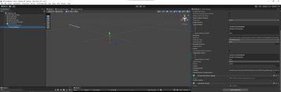

i want to use tpk for elevation and bas map for quest 2 VR with unity.
copy the tpk file in "/sdcard/Android/obb/com.Riaka.VRTutorials/" but in app dont show base map and elevation map.
string world2 = "/sdcard/Android/obb/com.Riaka.VRTutorials/world.tpk";
string Elevationfile2 = "/sdcard/Android/obb/com.Riaka.VRTutorials/ShirazDem.tpk";
mapComponent.Basemap = world2;
mapComponent.Elevation = Elevationfile2;

hamedsetorg
thank you for your solution. I test your code and copy tpk file to directory and check file.exist is false and app can not find the files and  ardsdk dont show and use from tpk file.
the directory Application.persistentDataPath="/sdcard/Android/data/com.Riaka.VRTutorials/files/ShirazDem.tpk"
is it need to do some config in player setting or copy to specific folder?
