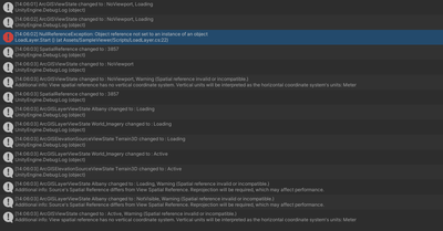

Can you please add the ArcGISViewStateLogging Component to your arcigs map component and send a picture of the console? Try loading it through script and try loading it how you were doing before and send the console so I can better help with debugging.

Here is my console trying to load from the persistent data path:
As you can see an error on line 22 of my script is being thrown:
