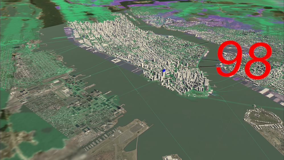

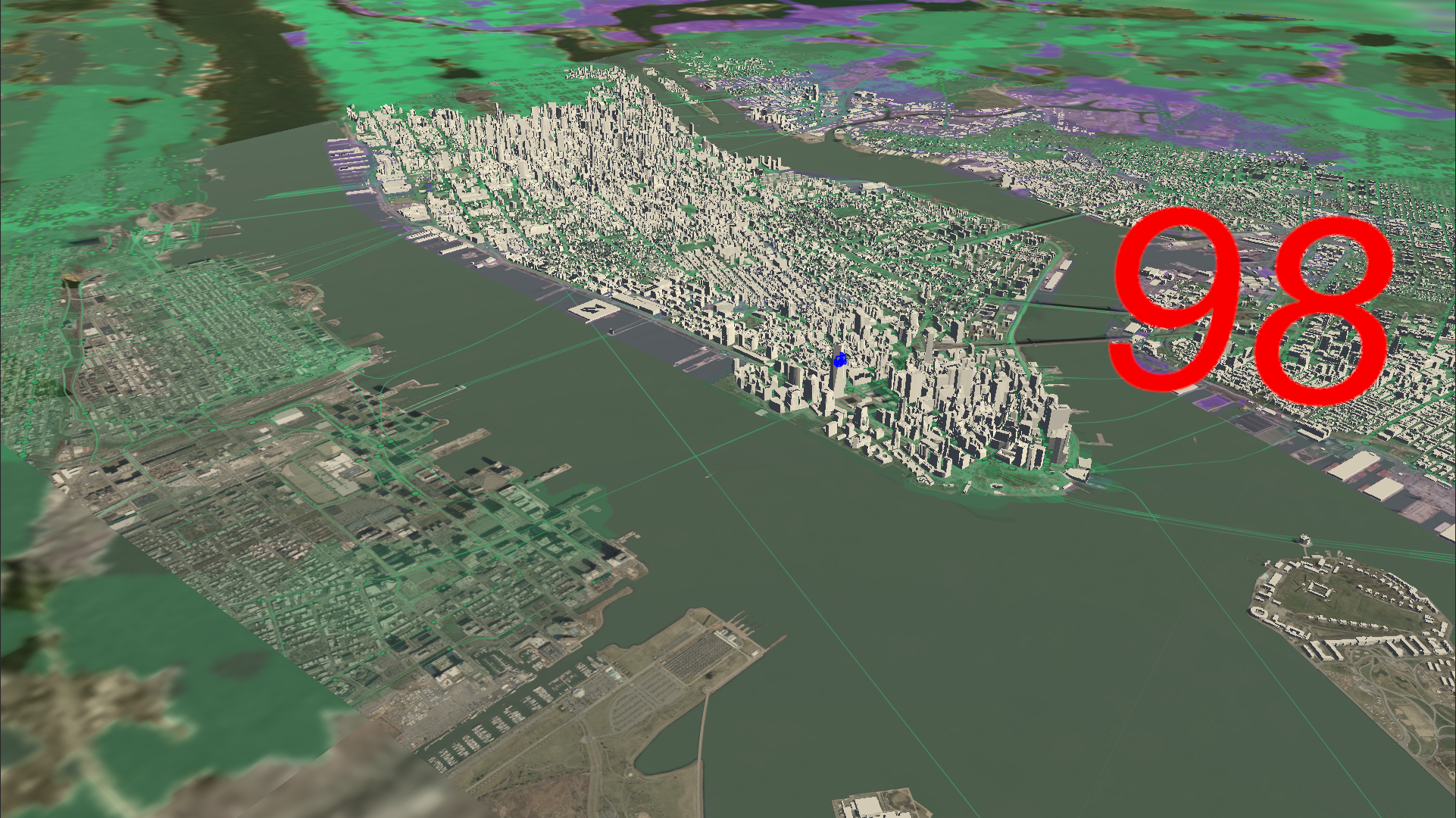

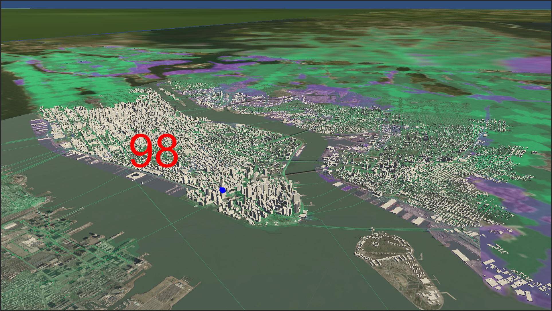

The problem summarized: If you raycast when camera is moving, there seems to be a chance for the raycast to hit somewhere that does not correspond to the correct geolocation. I assume this has something to do with the LOD loading or the map root position changing. However, as an end user, it seems completely unpredictable.
This problem can be recreated in the included ArcGISHitTestSample. Rapidly zoom in/out while shift-clicking on map features. When you click, the text should appear slightly offset from the position you clicked. However, it will sometimes end up kilometers in the air, as if you clicked a mesh collider that was still in place after the map root position had changed.
I am including an image here from 2 angles to help alleviate the issue of perspective. While zooming out, I clicked roughly on the blue dot, but the text object was placed far from that position, about 3km in the air.hittestA.PNGhittestB.PNG
