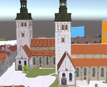

The left church is from the ArcMap script and the right is a OBJ file. Its the same church in ArcGIS Pro.

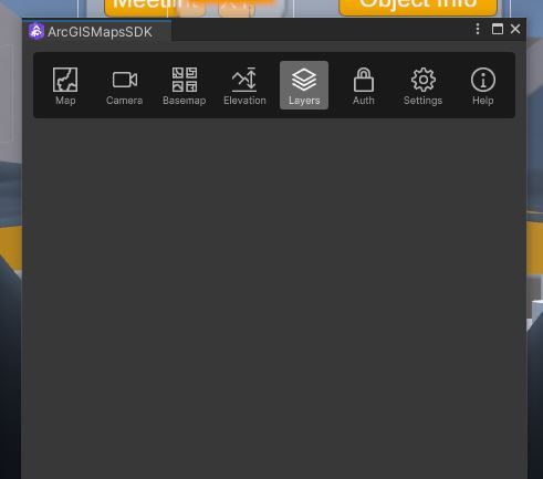

The ArcMap script is under the Main Camera and i have no layers add to the Map Creator.

In Unity you can also see for example that the left roof is not behaving normally. When i move in the Scene view the texture rotate or something.
(view in My Videos)
WH1981
(view in My Videos)
Sorry a video again. When stop the play modus you can see that the church is build out more fronts. But i opened the OBJ or DAE file in SketchUp and there are no more fronts. Maybe ArcGIS SDK renders to much textures.
