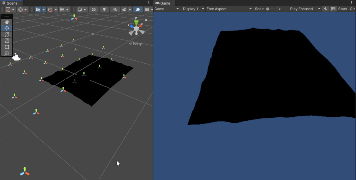

I've added the SDK via tarball in the UPM, and I've also added the samples content via the UPM. My project uses URP, so I've navigated to the Tabletop scene in Assets/Samples/ArcGIS Maps SDK for Unity/1.5.0/Sample Content/Scenes/URP/Tabletop, and added my API key in the ArcGISMap compoent. I get something, but the map is flickering and is mostly just black.Unity_240909-Hoatzin.gifUnity_240909-Hoatzin.gif Have a look at this gif:

This gif is from the HDRP scene, but I have not changed the project to HDRP. My project is quite large, so I don't want to mess with settings that might break things.

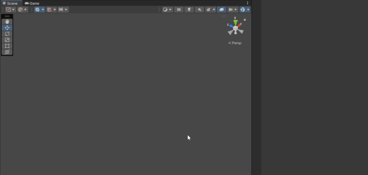

No I'm saying I want dynamic clipping. The ArcGIS SDK turns it off all the time, resulting in not being able to see anything in the scene view which is very annoying. Like this:
Just leave it on, I don't understand why you turn it off 🤔

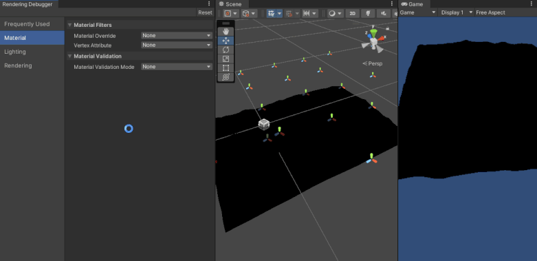

More investigation. It seems the flickering is related to some wonkiness with the normal maps? In this gif, you'll see that everything looks normal when going over the material overrides in the rendering debugger, until I get to the normal maps:
I made a new test project using Unity 2021.3.x and imported the SDK v1.5.0 via tarball, and this is not an issue in the plain test project. Here the material overrides for normal maps look fine.

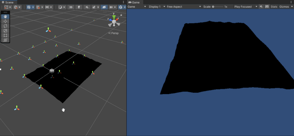

In any case, I've also realized that the flickering only happens when I have medium selected in quality settings:
So I can continue my testing for now, although I'm gonna need to be able to use the medium preset later, when building to standalone VR headsets...
