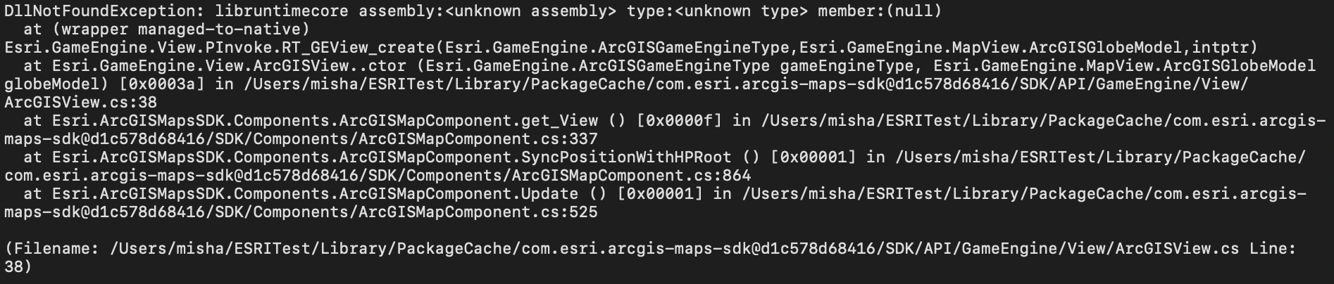

I'm running into an issue just the samples provided by the base ArcGIS for Unity package (Also when trying to use it inside my own application). All of the different sample scenes work inside the editor as intended. When the samples are built into a regular desktop application I get constant errors and nothing from ArcGIS appears on the screen:
They don't all come from the same place (i.e. some come from ArcGISCameraControllerComponent.cs but others from ArcGISLocationComponent.cs) but they all result in a DllNotFoundException: libruntimecore.

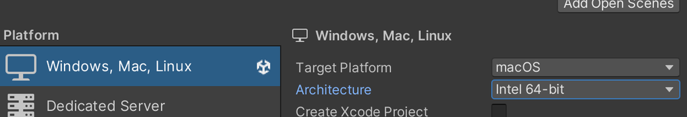

Hi, we tried building one of the sample scenes (Component Global Sample) on a machine with the M1 chip + Intel version of Unity but could not reproduce the error message. Since it's the Intel version of Unity editor, in the Build Settings we selected "Intel 64-Bit" for the Architecture option and the build was successful with the map data shown in the build application. Could you try this out and let us know if it works out for you?
