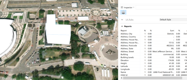

This screenshot shows that CityEngine places the building correctly.

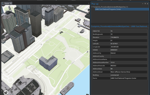

This screenshot shows that ArcGISPro has the same data that CityEngine does and positions the building correctly.

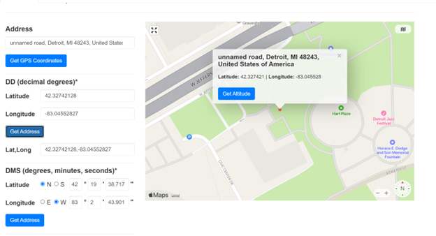

After googling the positional data, I can see that the lat longs provided by CityEngine are not where the buildings are being placed in the Esri programs
