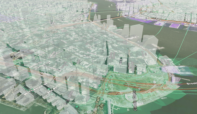

I am creating a map based experience in Unity. I want to add a 3D buildings layer to the map. It is a location based game, so I need there to be 3D buildings wherever a user is in the world. I found this scene layer but I am getting errors when I add it to the layer like this
ArcGISBuildingSceneLayer buildingSceneLayer = new ArcGISBuildingSceneLayer(
"https://basemaps3d.arcgis.com/arcgis/rest/services/OpenStreetMap3D_Buildings_v1/SceneServer", APIKey);
map.Layers.Add(buildingSceneLayer);
The error is 'invalid json'.
Question 1: how do I add basic 3D buildings to the map wherever in the world a user is located?
Question 2: If I wanted to alter the appearance of these buildings (ie. make them shorter or make the top half of the buildings fade into the air (transparent)), how would I go about doing this?

It seems that is the incorrect layer type. Please make sure the layer type is a 3DObjectSceneLayer instead of a BuildingSceneLayer. And also be sure you are in Global mode.
So it would be:
var buildingLayer = new Esri.GameEngine.Layers.ArcGIS3DObjectSceneLayer("https://basemaps3d.arcgis.com/arcgis/rest/services/OpenStreetMap3D_Buildings_v1/SceneServer", "Building Layer", 1.0f, true, "");
map.Layers.Add(buildingLayer);
If you want to make the building transparent as a whole, you can try the example below:
buildingLayer.Opacity = 0.5f;
But I don't think you can alter the individual appearance/height of these buildings.
Hope that helps!
