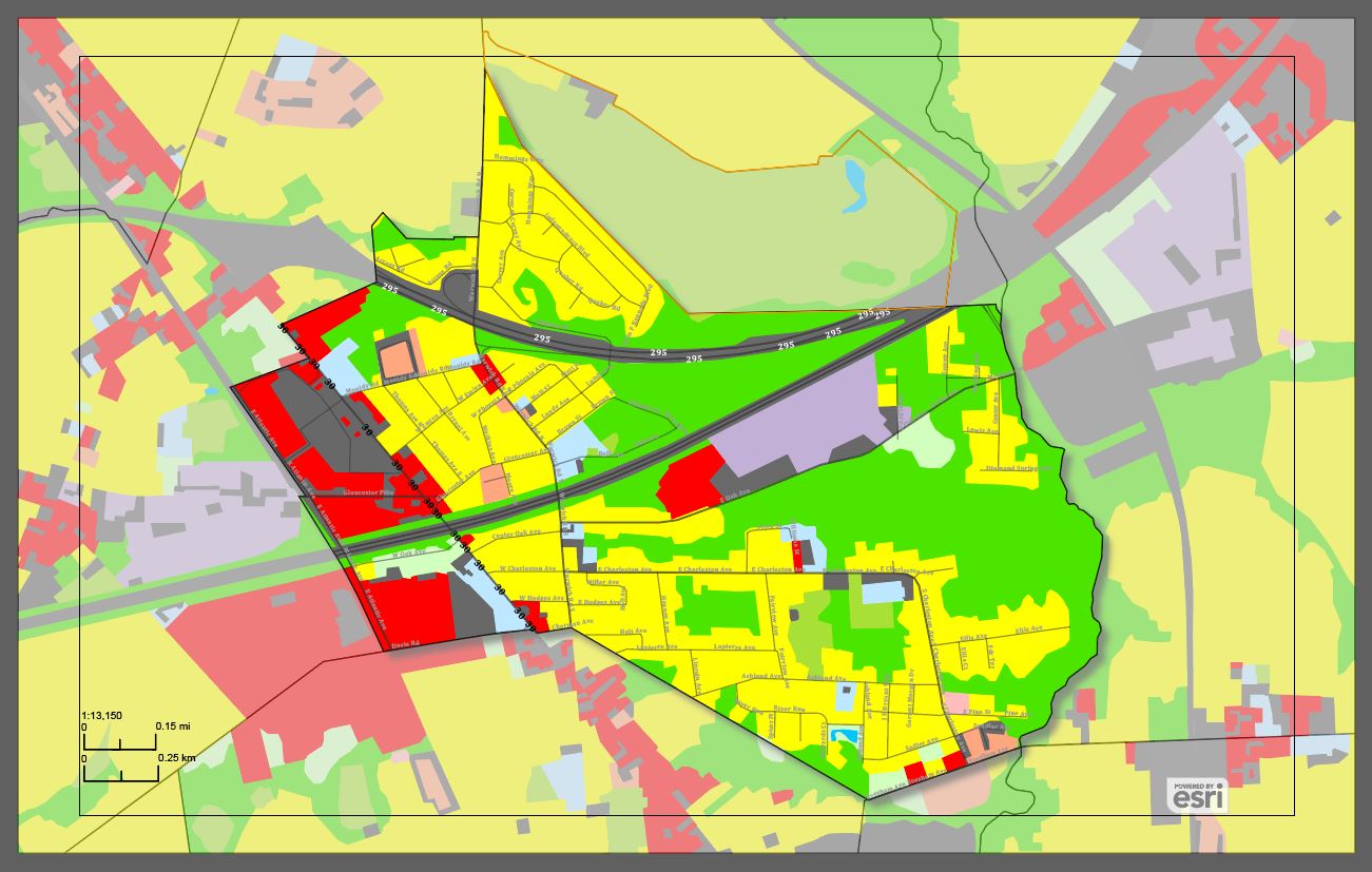

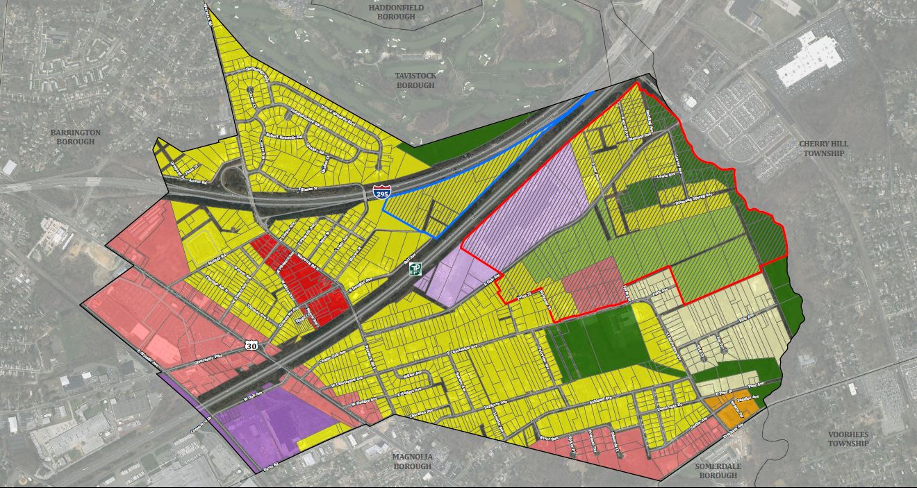

I just recently have become introduced to ArcGIS Maps for Adobe Creative Cloud.  I rarely use AI, so this is an adjustment for me for sure.  The first photo below is a screenshot of my AI project so far - I have accomplished the Drop Shadow that I wanted, which is great, but now I am stuck.  I need to rotate the data 16 degrees (see second screenshot for a separately created map via Pro).  When I rotate all the Layers in AI, it also makes the Data Frame rotated.  My long winded questions are: 1). Is there a way to rotate the data in AI to match my second map without rotating the actual data frame?  2). Is there any other way to create a Layout rather than opening up a Web Map from AGOL into Adobe?  I'm not too familiar with AI, so creating a Layout in here will take much wasted time (adding a legend, etc).
