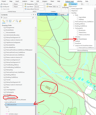

I exported a Layout from ArcGIS Pro to .aix.
In Pro I used Masking to mask contour lines under texts, using a masking layer and it works perfectly.

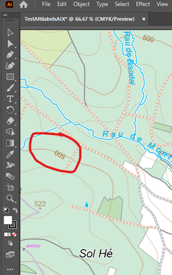

But in the .aix opened in Adobe Illustrator, the masking is not present.

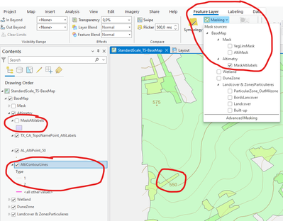

Thank you for your message! I created masks like shown on the image here under. So the MaskAltiLabels polygon layer masks the AltiContourLines line layer.
And in .aix the contour line is not masked:

Thanks for sharing your PPKX. It's been useful for identifying the crux of the issue. When exporting it as a PDF, it looks like the masks are a compound path. This compound path is dropped in the AIX. The team will look into retaining these types of masks in AIX exports. In the interim, please check the link I shared in my original response for the workflow to do this same effect in Illustrator as the team looks for a solution.
