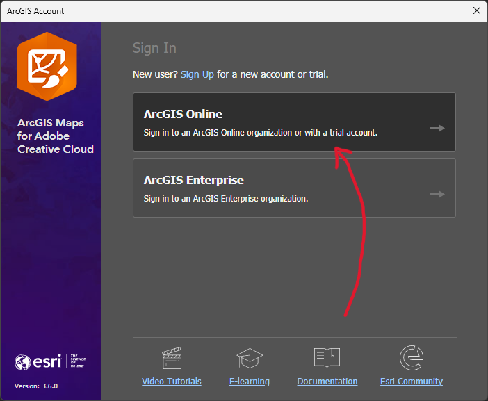

Hi, I download and install ArcGIS for Adobe Creative Cloud but I was was unable to login using the windows within de Illustrator because the ArcGIS Online button not works, once press do nothing meanwhile the ArcGIS Enterprise button works without problems.

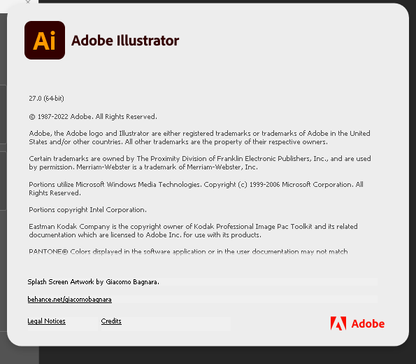

I'm using Illustrator v27 and v28.

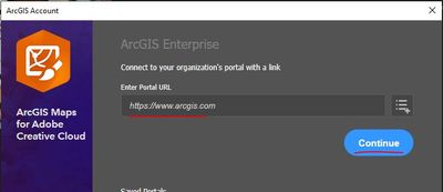

Ashley_kuhn
Thank you for testing the chrome and edge login. For the Enterprise login, instead of an enterprise URL you can enter https://www.arcgis.com and it will direct you to sign in with any online account.

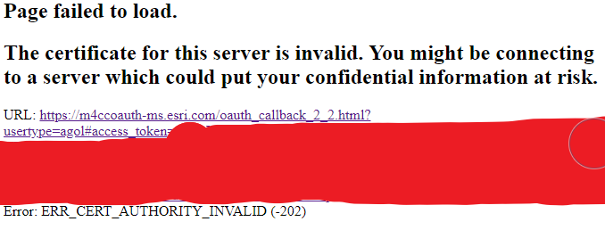

I am running into a similar issue when trying to log  to ArcGIS Maps for Creative Cloud in after a while. I have a license through my AGOL account and I can log in through all the browsers but when I try through Illustrator I get this error (I covered up the token info):
I am on Illustrator  v 25.1 Not sure what to do about this?

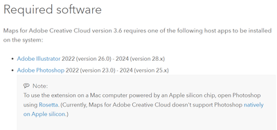

Anna_Breton
Hi @CharmaleeSandanayake1 ,
It looks like you're running the extension on a non-supported version of Adobe Illustrator (version 25.1). Here is our documentation on supported Illustrator versions:
I suggest updating your version of Illustrator to the latest supported version, as well as updating your version of the Maps for Adobe extension to 3.6. It looks like you may still be on version 2.2. Updating both Illustrator and the extension should hopefully resolve the issue you're seeing. Let me know if this helps!
Thanks for the reply Anna.  I was able to upgrade my Illustrator to v 27.9 and Maps for Adobe extension to 3.6. When I go to log into ArcGIS Online I still get that same error message screen. However it does work when I disconnect from my organization's VPN. Something in our organization's network settings or firewall must be blocking access to ArcGIS Online authentication through Illustrator. I can speak to my IT about it but would you have any recommendations?
