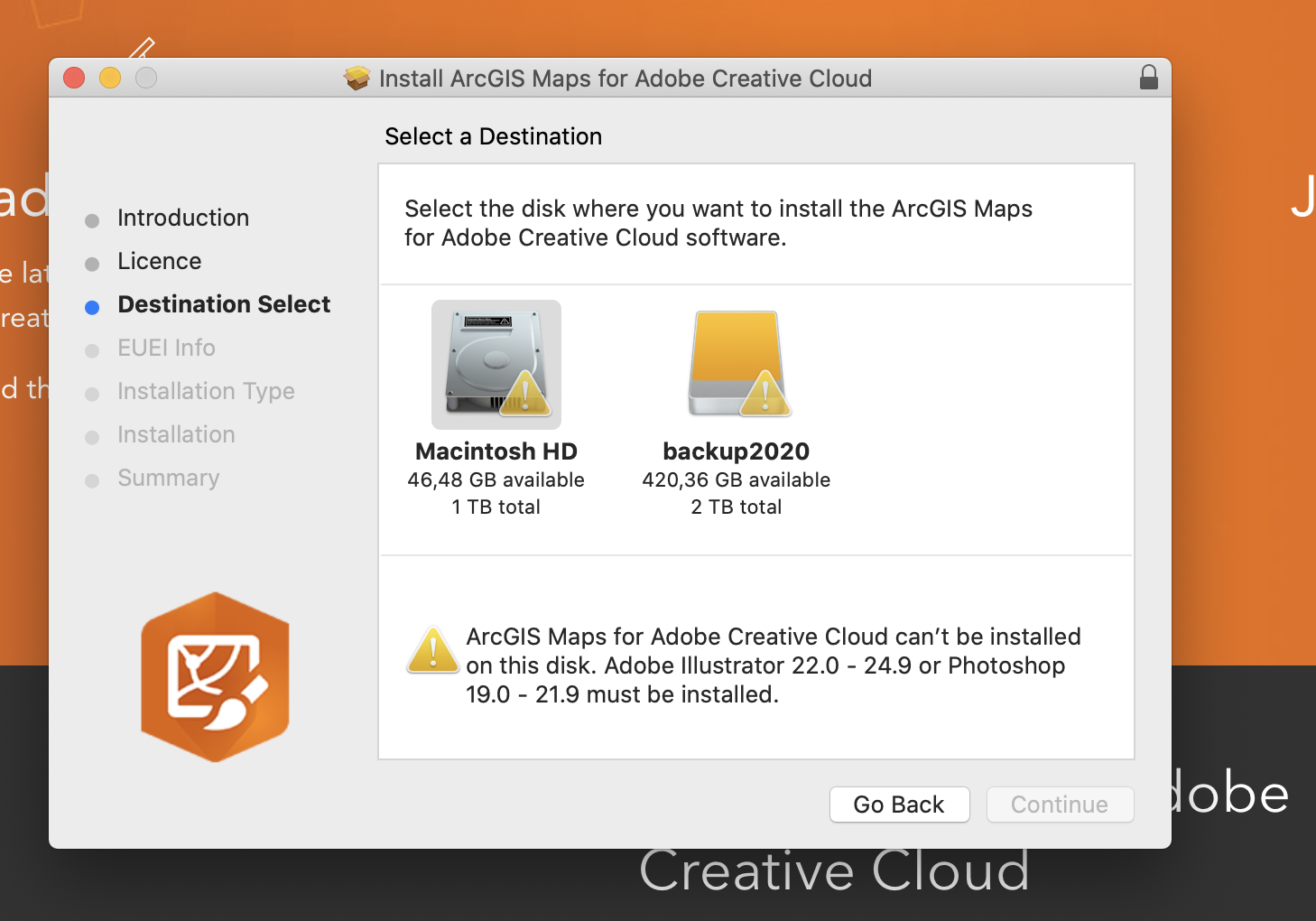

I tried to install the plug on a mac and give this message error:
I installed a older version of Illustrator, the 24.3 and give again the same message......I uninstalled the new one (25.3.1) and still give again the same error message...what I can do more to solve this?

You need the older version of illustrator. I believe two updates behind for it to work.

I've been having this problem for a while - can't install on my imac. Running the latest version of Illustrator.  Same message - can't be installed on this disk. Yet I've been able to install it on my macbook pro.
interpretdesign
still getting the same error. I completely uninstalled creative cloud, reinstalled - same error.

Thanks for reaching out to the team. Looks like the installer fails to find a compatible version of Illustrator or Photoshop on the disk. Could you please share some info about your environment if if you have done so.
- Is your iMac on Apple silicon M1 chip or Intel chip?
- What's the macOS version?
- What's the Illustrator version?
- What language and where your Illustrator is installed? you can get that info from the preference setting of the user's account at the Creative Cloud desktop app.
Have you tried to install a supported version of Photoshop and run the install again? Maps for Adobe supports both Illustrator and Photoshop.  If the installer detects a supported app (in this case Photoshop), it installs the extension and the extension will be available in Illustrator as well.
