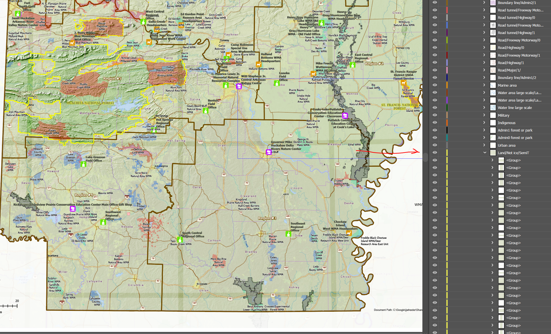

Has anyone had this problem where a layout with an esri basemap is exported from Pro and brought into Illustrator with what looks like overlapping tiles or gridlines? I narrowed it down to the layer in the basemap (National Geographic Style) called "Land/Not Ice/SemiT." If I turn that off, the grids go away. When I export from Pro as a pdf and open in Illustrator, the grids are not there.

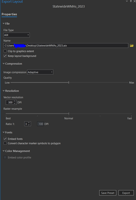

Can you show us your Export Settings in a screenshot ?
Jeaner
by
I also tried the rasterize in export off/on and that didn't fix it.

Can you screenshot your Layout and I think maybe you should move the layer for this Land/Not Ice/SemiT to be very at the top if it is only showing lines only. otherwise if  you can try highlight it in Illustrator at the top and see if it works or not.
I think that layer is hiding from the rest of the other layers so maybe it is why it is not showing up

I read it what you are suggesting and now I can see why ! I had a similar  the one with in Photoshop so I will try that and see if that works. Though I know it is not the same thing .
Jeaner
by
Thank you! I was able to workaround this using your suggestions.
