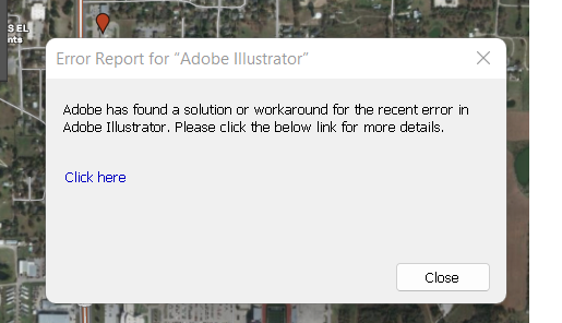

After selecting a .aix file within Illustrator, while using the ArcGIS Maps for Adobe Extension (version 3.30) When I attempt to "Save As" .ai, Adobe crashes with this vague error message. I'm running the newest version of Adobe Illustrator. I can "Save As" other file types, but only crash with .ai.
"Click Here"
Any suggestions?

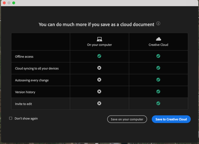

@GLaneERG Thanks for sharing your AIX file. I'm able to reproduce the issue you're seeing. The team will definitely take a look at this specific case and try to find a solution. Do you mind sharing what version of ArcGIS Pro you're using? Also, any chance you're able to save to your Creative Cloud account instead of to your computer?Screen Shot 2022-11-09 at 9.56.13 AM.png
