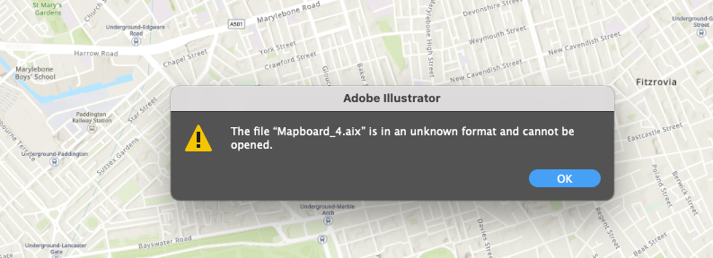

Thank you so much for this update, however it is causing some issues.
I upgraded the plugin and it was getting stuck at 40% on Illustrator 2023, now that I've updated it to 2024 I'm getting an issue where it is not recognising the file format and causing errors.
Xingdong_Zhang
@KathleenAdele As ArcGIS Maps for Adobe is a plug-in running on the top of Adobe Illustrator, every major upgrade of Illustrator (e.g. from version 2023 to 2024) requires a reinstall of the extension. Could you try reinstalling the app to see if that solves the problem?

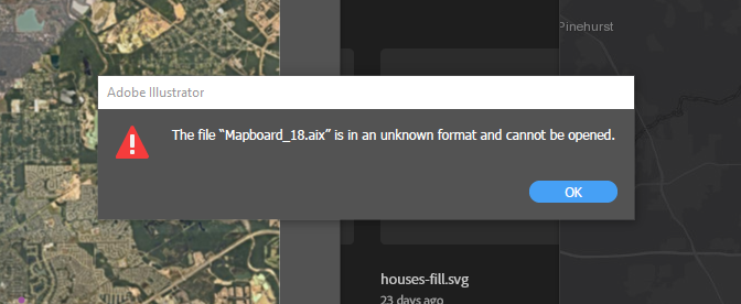

ChrisMyers_NewQuest
Hi @Anna_Breton , are you saying that Maps for Adobe CC v3.6 and Adobe AI v28.0 are compatible? Because I'm receiving multiuple errors when using those two versions, including "Cannot access download folder" and "the .aix file type is not recognized". I've reverted back to AI v27.7 to get around the issue. Can you confirm these versions are compatible?

Anna_Breton
Hi @ChrisMyers_NewQuest ,
The issue you're running into looks like it's related to you download folder naming convention. We've seen this with OneDrive users. Please see this post for the two workarounds for this issue. https://community.esri.com/t5/arcgis-maps-for-adobe-creative-cloud-questions/error-when-syncing-into...
