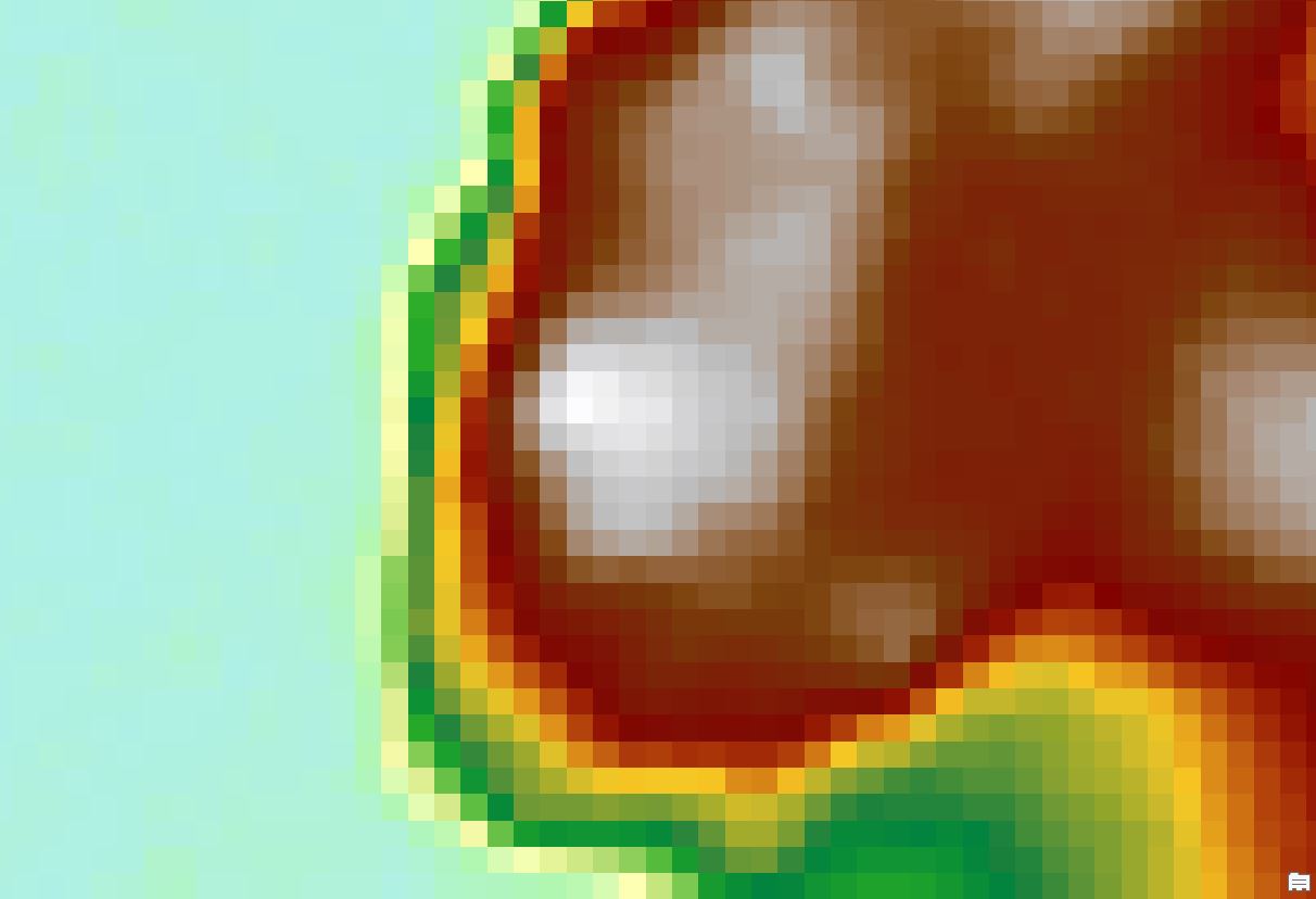

Original DEM

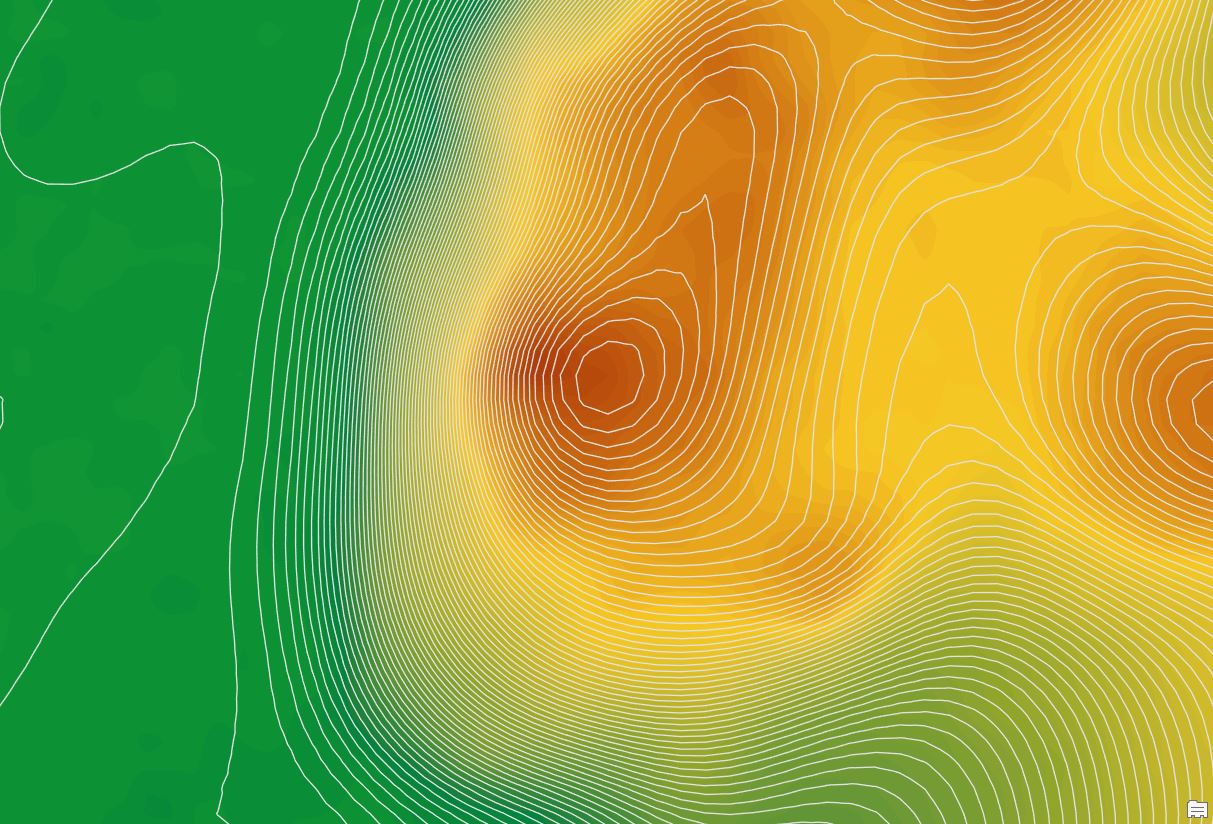

The process I am using is starting with the output from the Contour function under the Raster Functions in ArcGIS Pro.  The image below is the output from the Raster Function with the defaults.  The contour lines are the output from Contour under Raster Functions.  The DEM below it is also a product of the Contour tool under Raster Functions.  It is the Smoothed Surface Only output.  The two together match up very well and I like the output.
RasterFunction Contour and the Smooth Surface Only output
